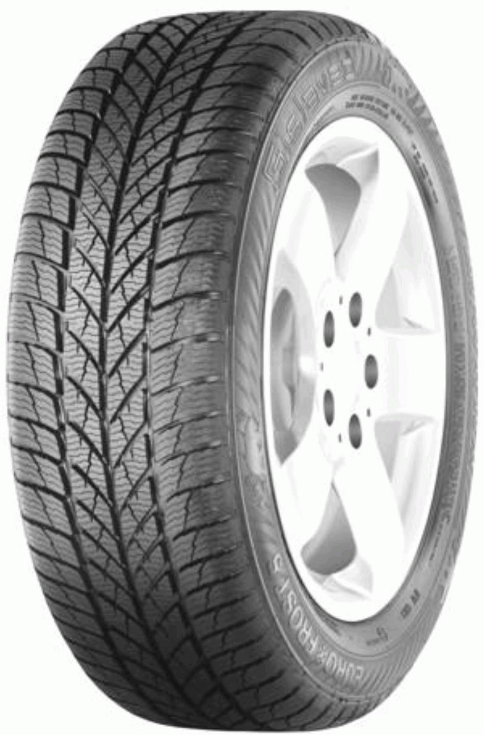

[TD=width: 100px]tGislaved-EuroFrost-5.jpg[/TD]
[TD=width: 540px]14th: Gislaved EuroFrost 5
Total: 70.7 / Wet: 41.7 / Snow: 29

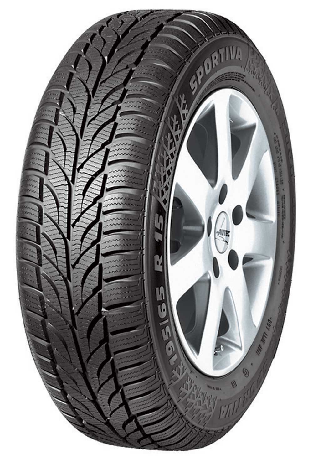

[TD=width: 100px]tSportiva-Snow-Winter.jpg[/TD]
[TD=width: 540px]25th: Sportiva Snow Winter
Total: 72.1 / Wet: 43 / Snow: 29.1
[/TD]

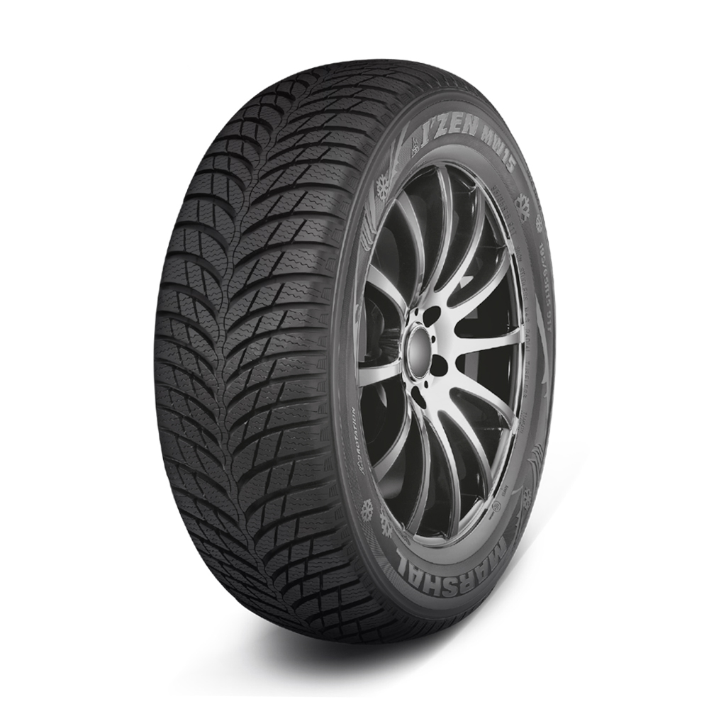

[TD=width: 100px]tMarshal-i-Zen-MW15.jpg[/TD]
[TD=width: 540px]37th: Marshal i Zen MW15
Total: 47.5 / Wet: 47.4 / Snow: 0.1

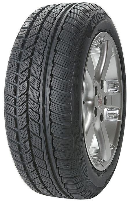

[TD=width: 100px]tAvon-Ice-Touring.jpg[/TD]
[TD=width: 540px]39th: Avon Ice Touring
Total: 48 / Wet: 47.9 / Snow: 0.1

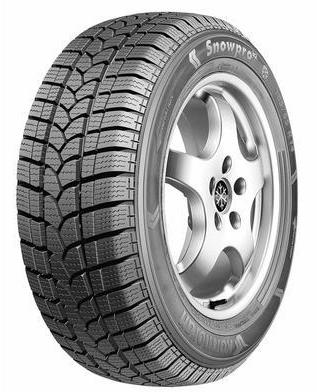

[TD=width: 100px]tKormoran-Snowpro-B2.jpg[/TD]
[TD=width: 540px]42nd: Kormoran Snowpro B2
Total: 48.7 / Wet: 48.6 / Snow: 0.1
