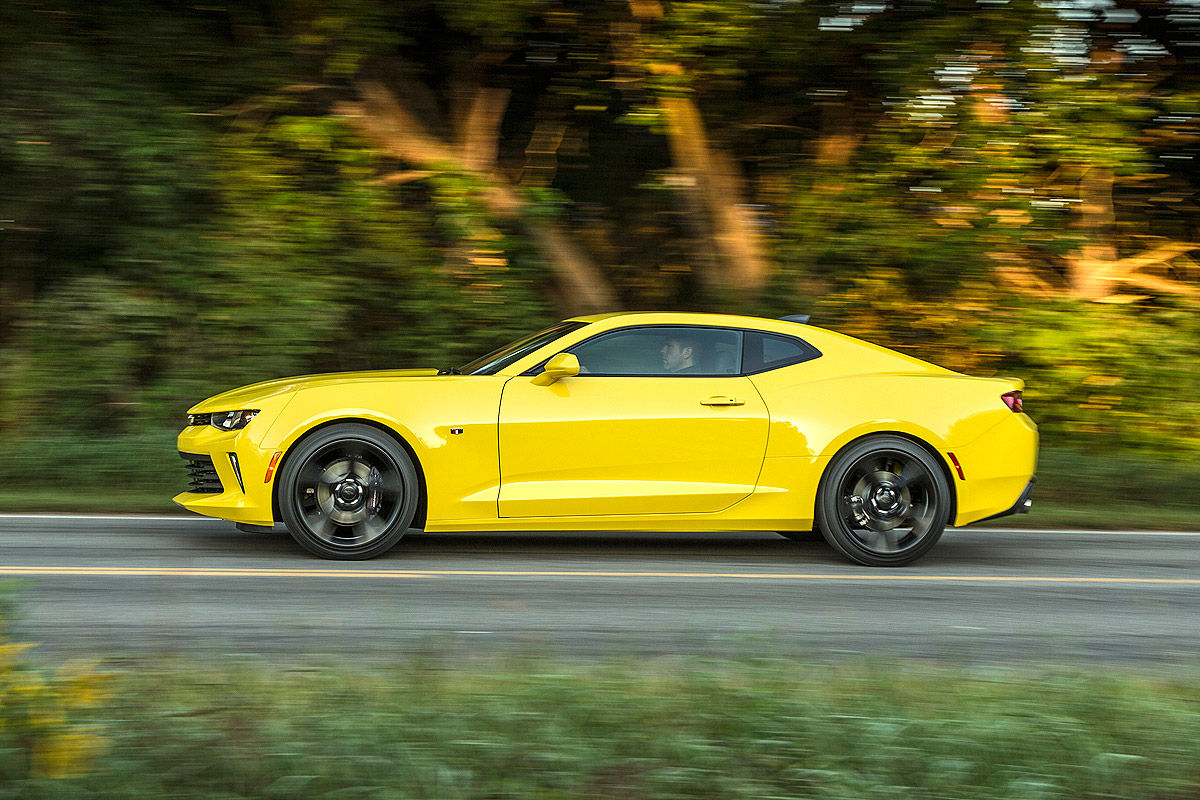

Very few nameplates have been around as long as this magazine. The Camarowasn’t there at the very beginning, but, having made its debut in 1967, it’s still one of the oldest model names on sale today. And when it celebrates its own milestone of 50 years in 2017, the Camaro will have a useful emblem with which to mark the occasion: this all-new sixth-generation car.
It is common in our business to be presented with a new model that looks vastly different from its predecessor but is mechanically similar. The 2016 Camaro takes the opposite approach: It bears a close resemblance to the fifth-generation car but is, in fact, based on a different platform.

When it comes to the question of how to update a retro design, Chevrolet is taking the path blazed by the Ford Mustang: refine, rather than overhaul. This isn’t to say that the new car is unchanged. In fact, it seems simultaneously cleaner and a little more muscular than its predecessor. The angered front face of the Camaro remains, though the grille openings are sharper and better integrated with the headlights. The rear window is flatter and the central depression in the roof more pronounced.
Look closely and you’ll notice interesting details such as the small air intakes below the running lights in the lower-front corners. These channel air to the outside of the fender wells, reducing aerodynamic drag. At the edge of the roof, there’s no trim strip to cover what can sometimes be a messy weld because, here, the roof and door apertures are laser brazed, yielding a much neater joint. And the hood vents on the SS are fully functional; they relieve underhood pressure to reduce lift.
