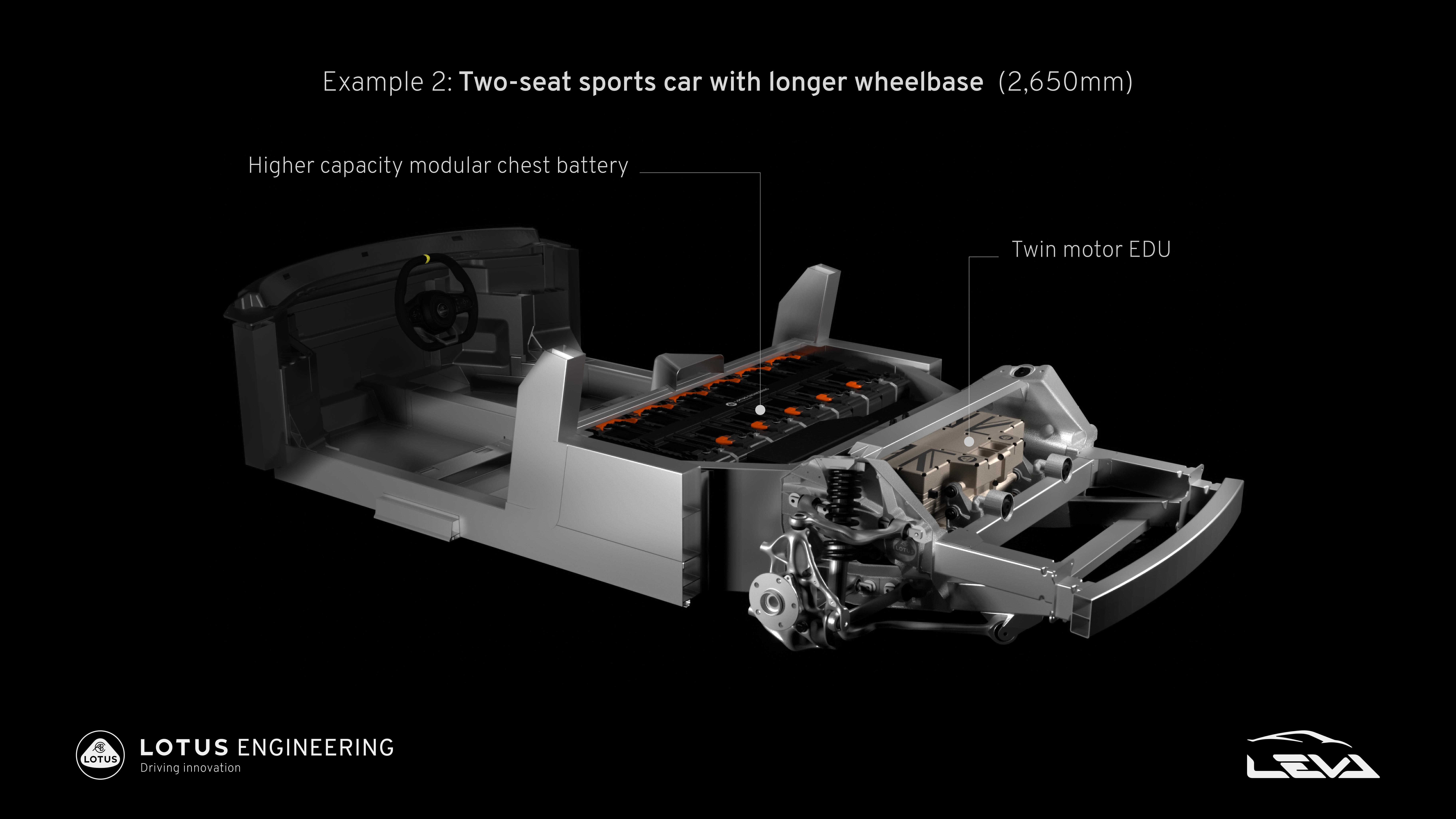

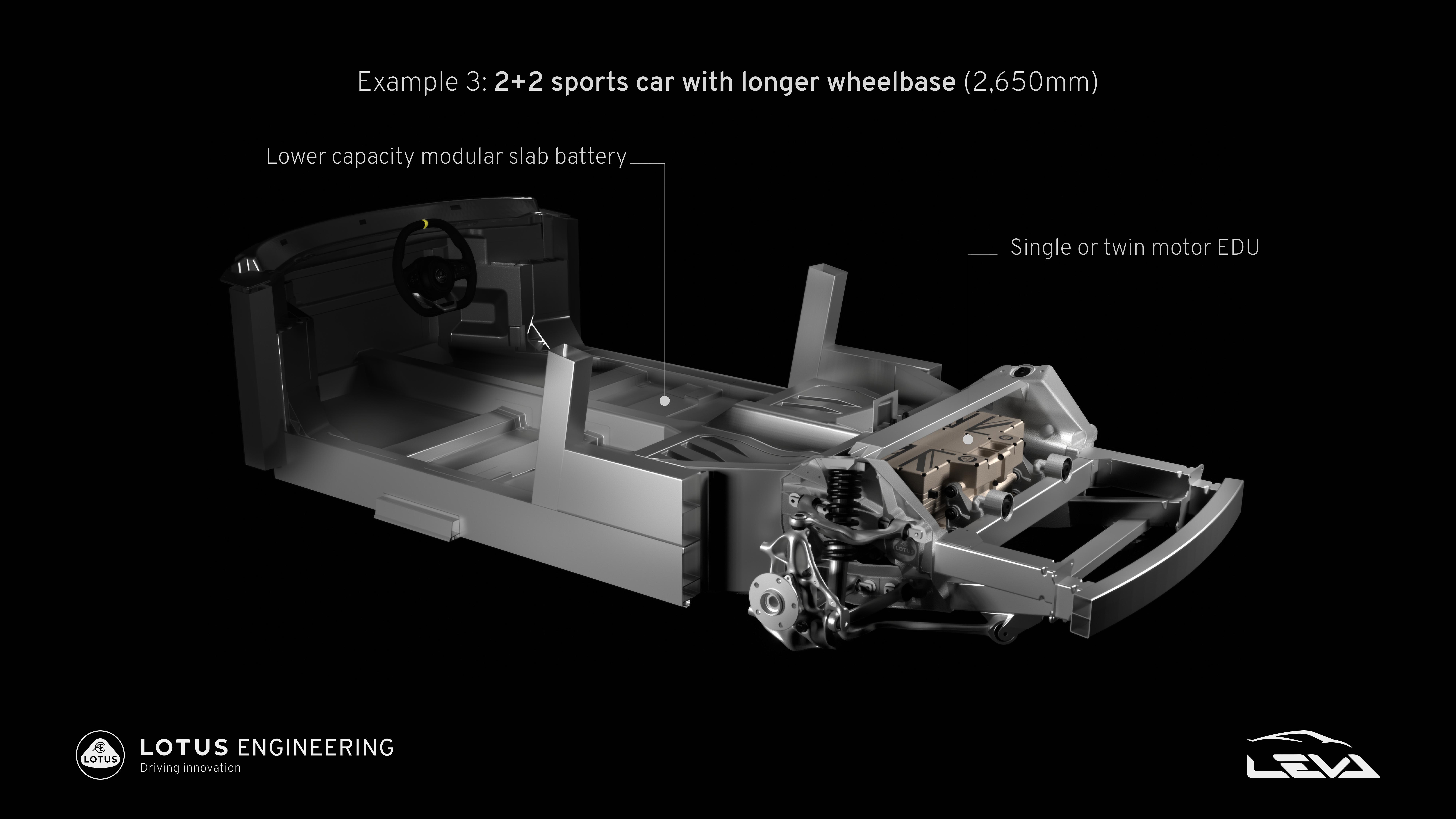

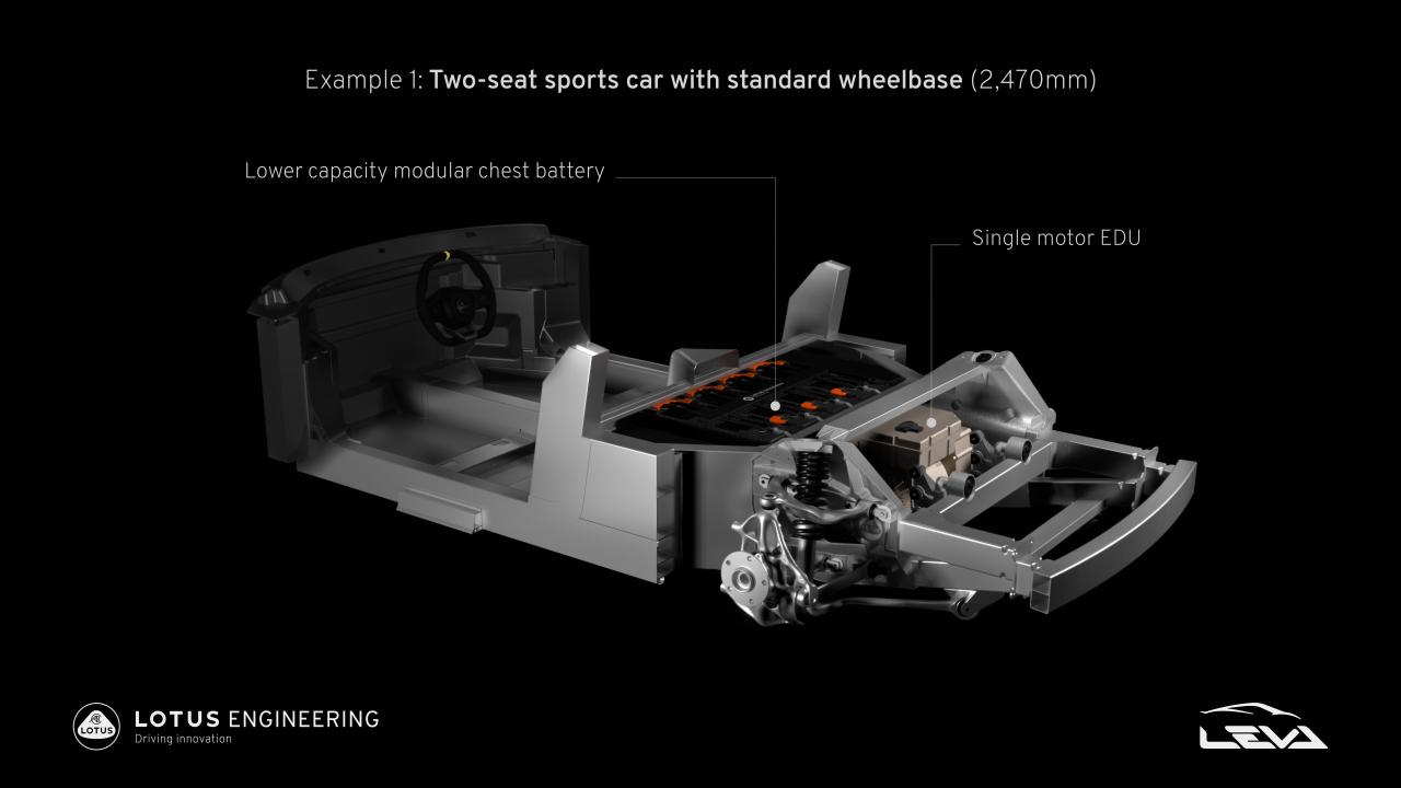

A new animation from Lotus reveals how the technology will form part of the new electric sports car chassis, illustrating the versatile nature of this all-new Lotus-developed vehicle architecture. It is fully adaptable to provide a platform for a range of EVs with variable layouts, wheelbase lengths, battery sizes and configurations.
As the animation shows, all three layouts feature a common lightweight die-cast rear sub-frame with multiple interchangeable components. This is the Project LEVA innovation, and it means a single vehicle architecture can accommodate two different types of battery configurations:
VEHICLE LAYOUT
WHEELBASE
BATTERY SIZE / CONFIGURATION
MAXIMUM BATTERY POWER
EDU LAYOUT / MAX POWER
Two-seater
Minimum of 2,470mm
8-module / chest
66.4kWh
Single / 350kW
Two-seater
More than 2,650mm
12-module / chest
99.6kWh
Twin / 650kW
2+2
More than 2,650mm
8-module / slab
66.4kWh
Single / 350 kW or Twin / 650kW
-       ‘Chest’ layout, where the modules are stacked vertically behind the two seats. A chest layout is a ‘mid-mounted power pack’, ideal for sports car / hypercar vehicle types where a low overall ride height and low centre of gravity are required, and as seen on the Lotus Evija pure electric hypercar.
-       ‘Slab’ layout, where the modules are integrated horizontally under the cabin. This is most suitable for vehicles where a higher ride height and a taller overall profile is required. It is often referred to as a ‘skateboard power pack’ layout.
The innovative new subframe features cylindrical battery cells for high energy density, with the option of a single or twin electronic drive unit (EDU) to support. Cold cure, spot bonding and advanced weld processes mean reduced environmental impact during assembly.

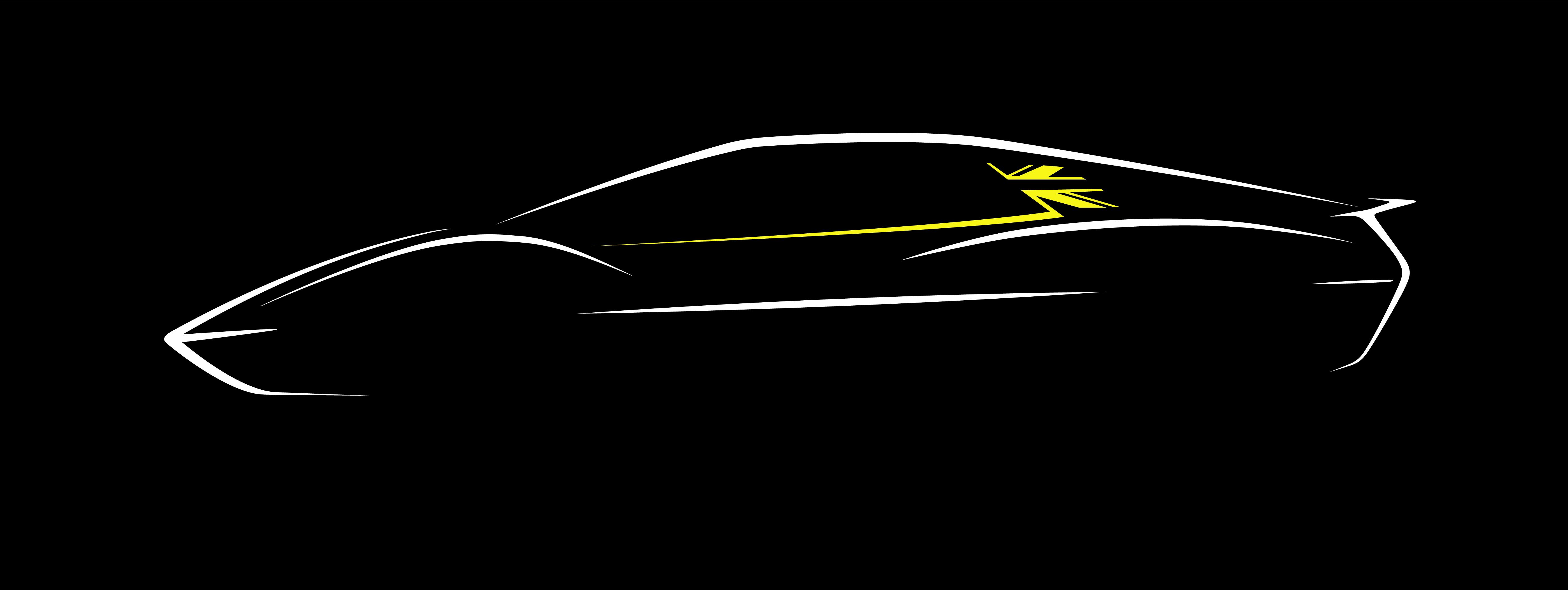

Lotus to collaborate with Britishvolt as sketch of future EV sports car is released
  • Lotus and Britishvolt sign MoU to collaborate on advanced EV technology
  • Partnership to co-develop innovative EV package to power new generation EV sports car
  • Design sketch provides first clues to new Lotus EV sports car
(Hethel, UK – 28 January 2022) - Lotus and battery cell expert Britishvolt have signed an MoU to collaborate on the research and development of advanced new EV technology.
The partnership will focus on the co-development of an innovative new battery cell package to power the next generation of electric sports cars from Lotus. The package is set to feature in a new sports car, powered by Britishvolt cells and utilising advanced electric propulsion technologies developed by Lotus. An official design sketch provides the first clues to a new Lotus EV sports car.
